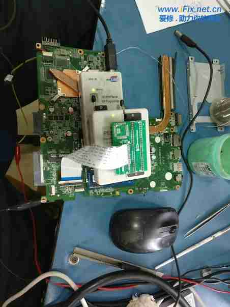

神舟zh6-71-W65S0-D2 it8587的ec内置程序有读出的吗??
ok  可以的现在市面上都是假的  如果机器上是好的可以选择在线读写和离线读写的     离线读写需要把100脚接地
发表于: 2016-9-5 08:47:33
看你的图片是100脚没接地!

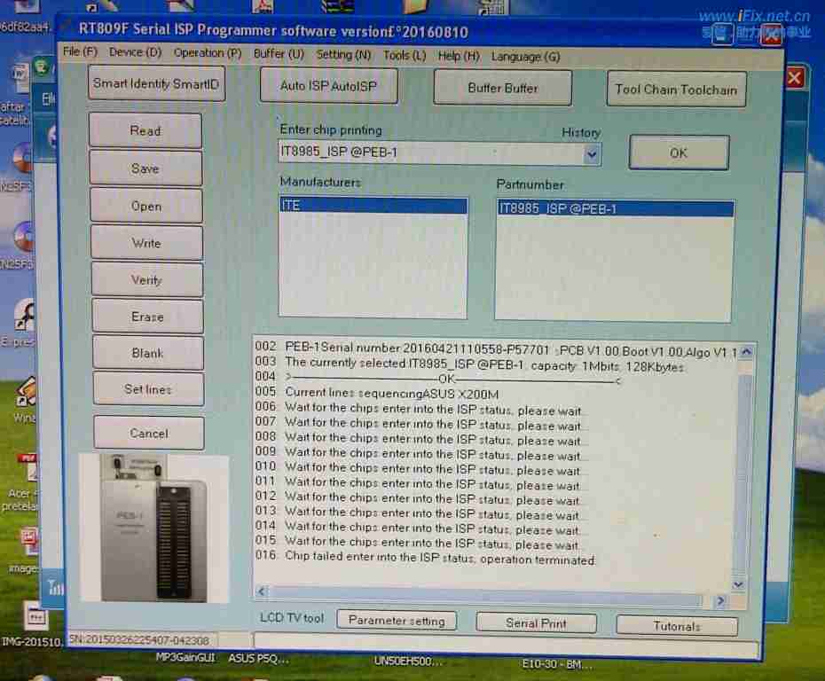

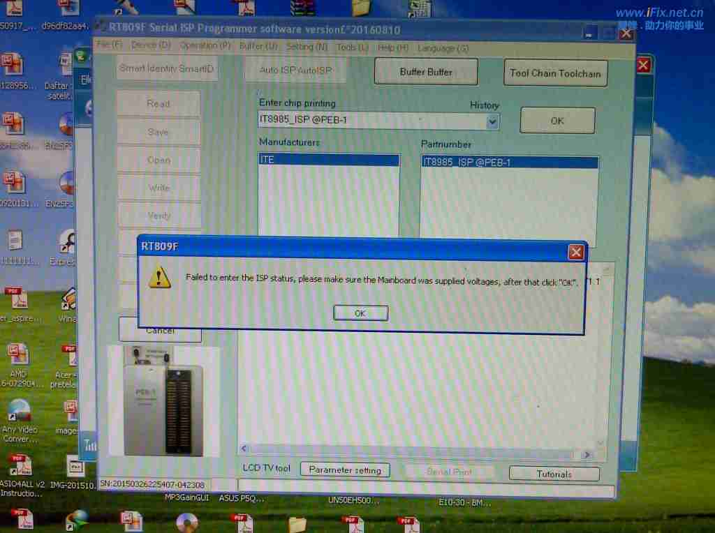

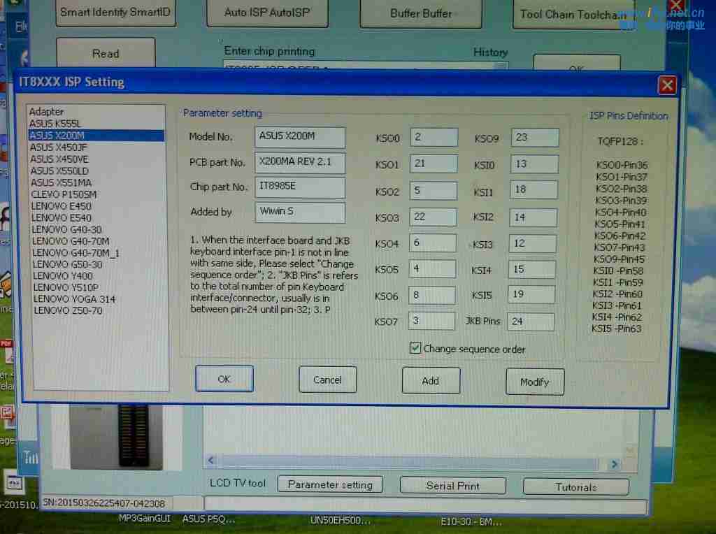

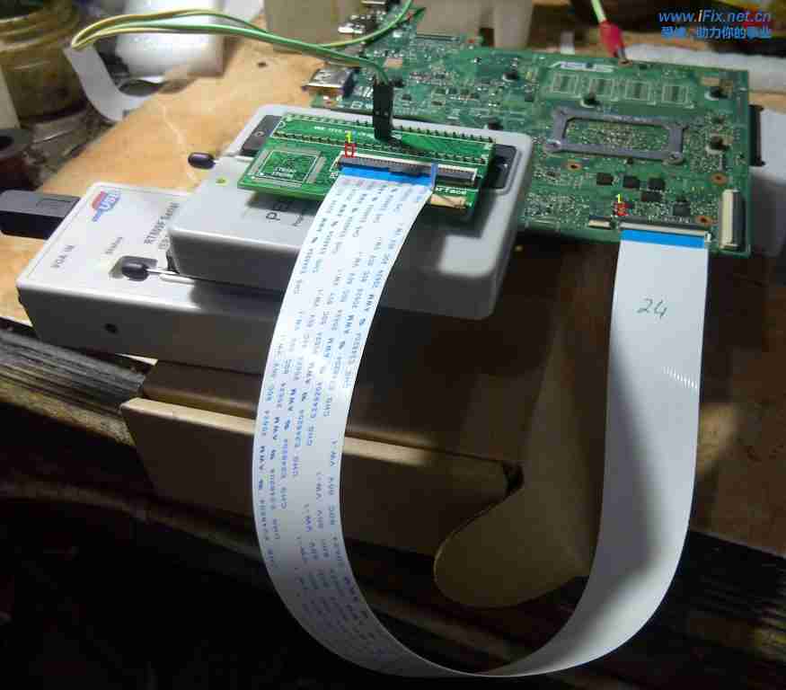

hellow sir,
how to backup EC BIOS asus X200MA Rev 2.1 _ KBC IT8985E, JKB pin-24
I used the software version 20160810
if there are errors in this way?
I've tried also to connect pin100 to gnd, but still error
please prompts and solutions

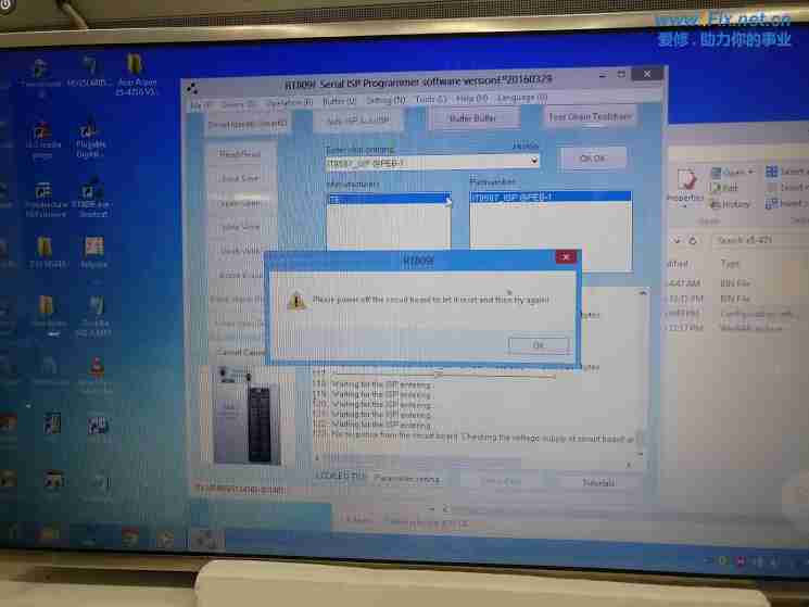

pls giva solution for acer e5-471 it8587 program
