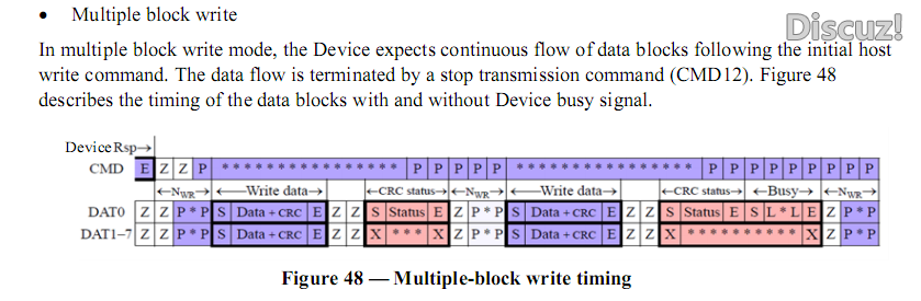

The EMMC write timing is shown in the figure. May I borrow your words, Do You know that? ( Maybe you don't know that ? )
The EMMC controller will return the CRC status after receiving a packet of data. After EMMC is corrupted, it always returns the wrong CRC status. The programmer software will prompt data error or CRC error, or transmission error, etc.  Is this your excuse for attacking RT809H?
