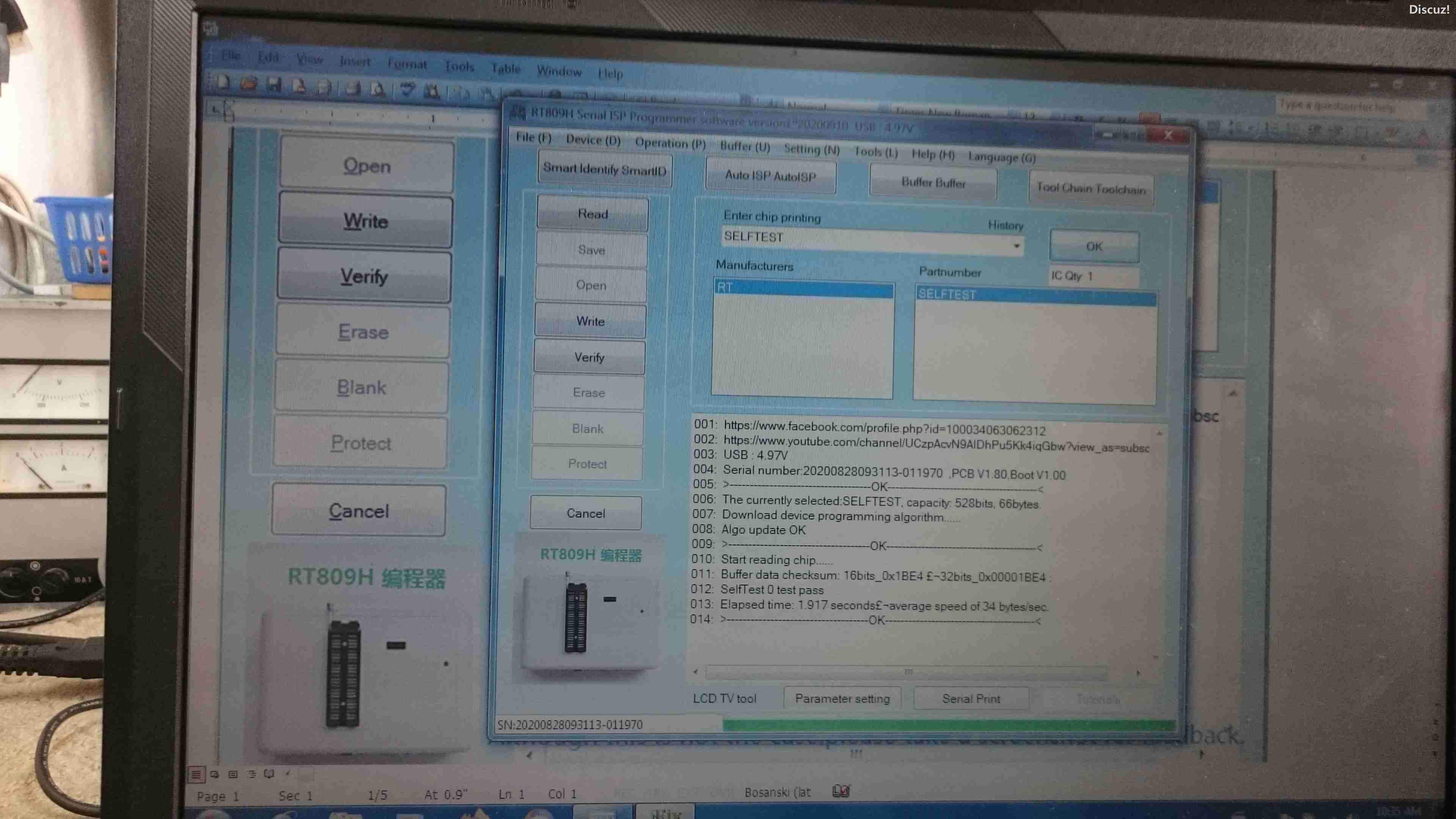

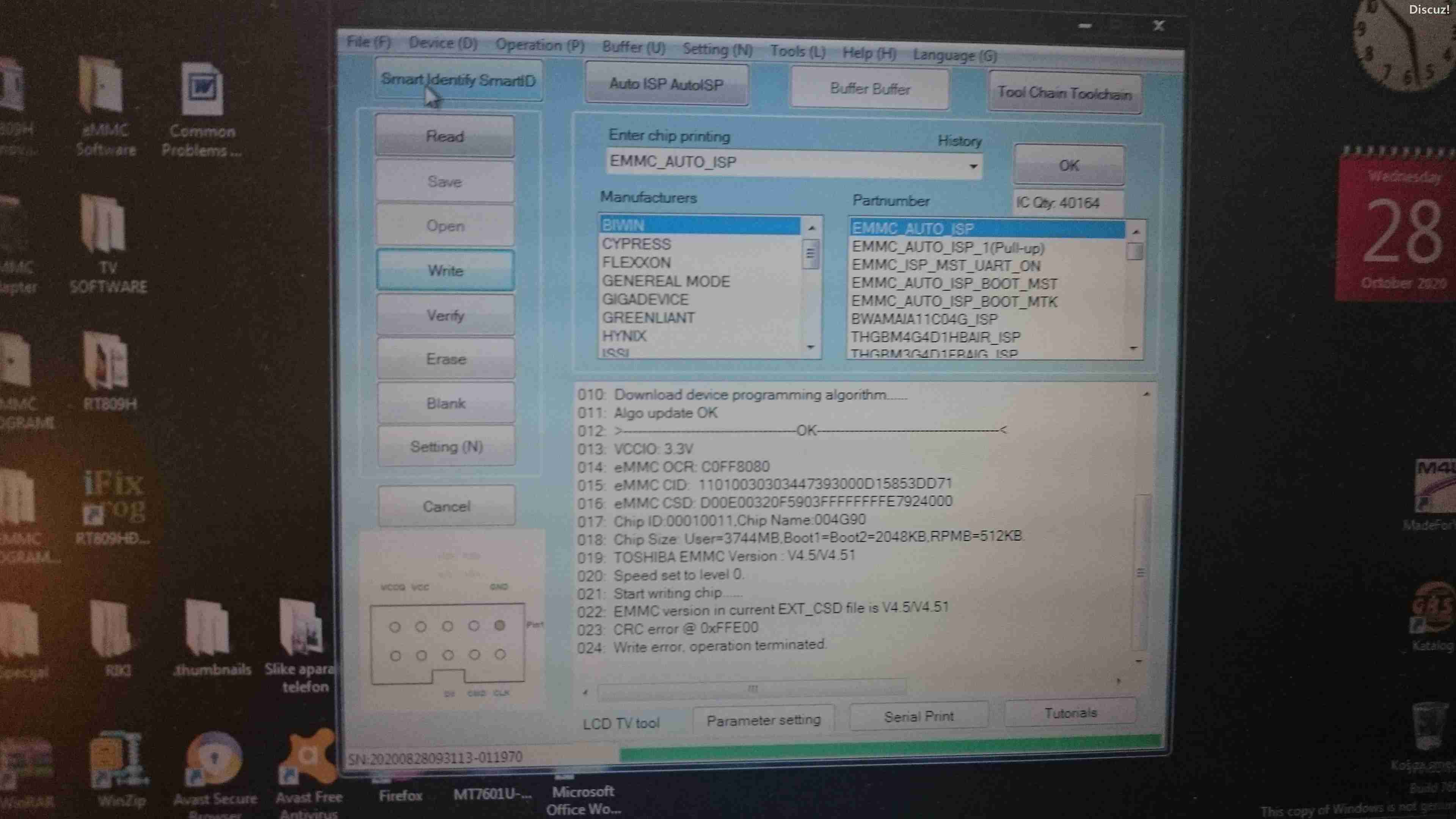

I did everything as you wrote. I did a self test, look at the result in photo Nr 001. Self Test my programmer is OK !

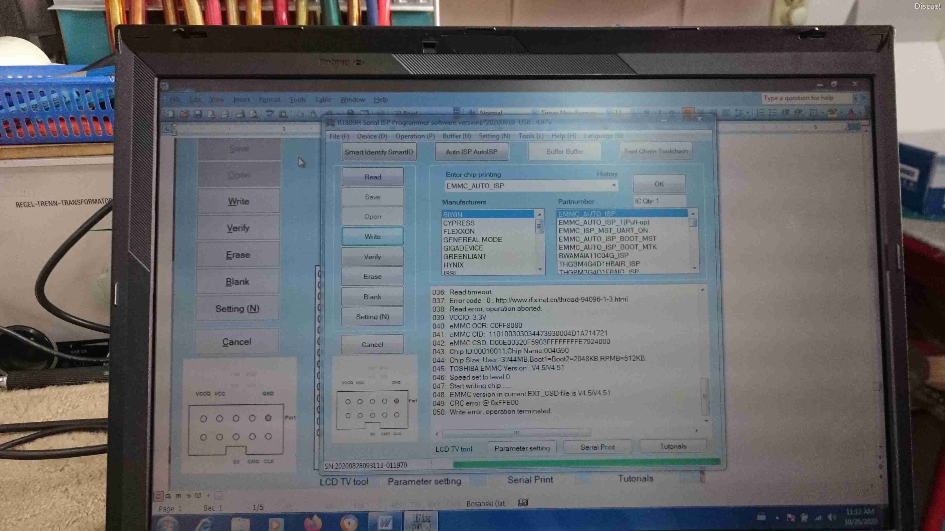

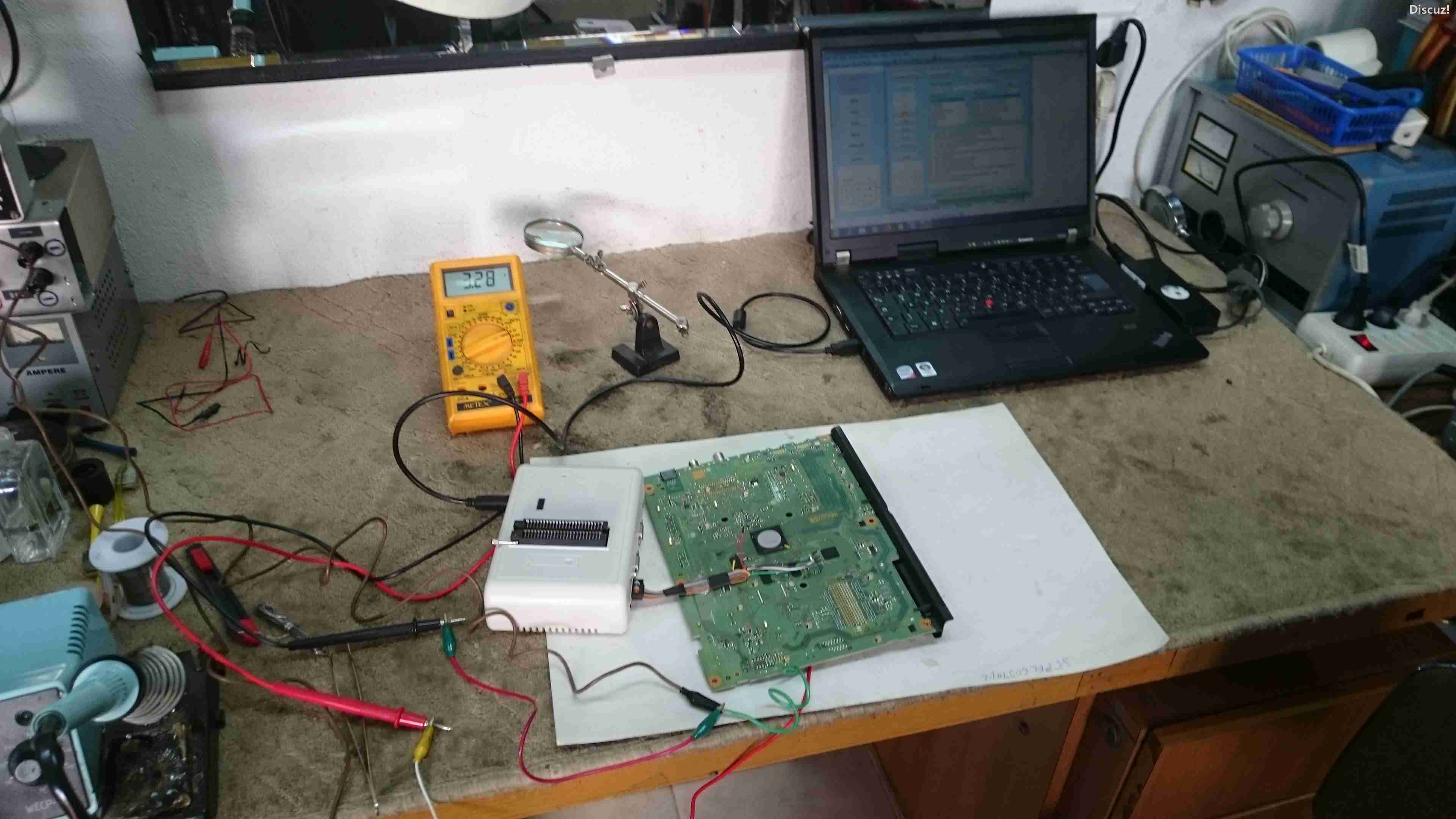

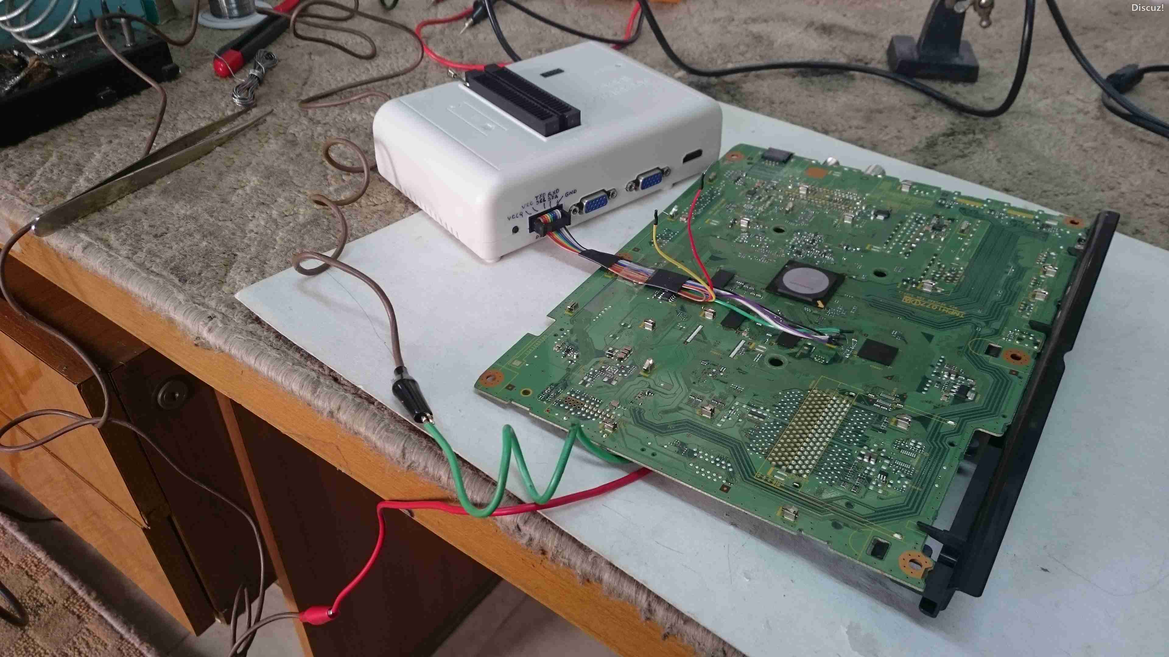

After the selftest, I connected the ISP wire to the mainboard exactly as you described. On the mainboard I connected an external power supply with + 3.3V. See photos NR 002, 003 and 004. After that, I plugged the ISP connector into the programmer, see this photos 002, 003 and 004.
I tried to do a READ but failed. Look at photo 005.
I also tried to do WRITE but I didn't succeed either. See photo 006.(Writing I tried with eMMC dump for Panasonic chassis TNPH1077 1A, which I have, but I'm not sure if it's good.)

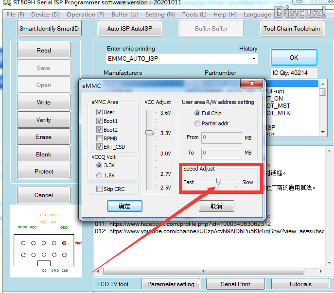

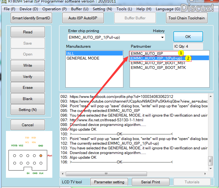

It has nothing to do with the software version.Emmc has been identified so far, read and write failure to consider your power and EMMC chip.You can try to use other 3.3V stabilized power supply and disconnect CLK and D0 external resistors. ISP will test the two modes one by one QQ图片20201027163901.png

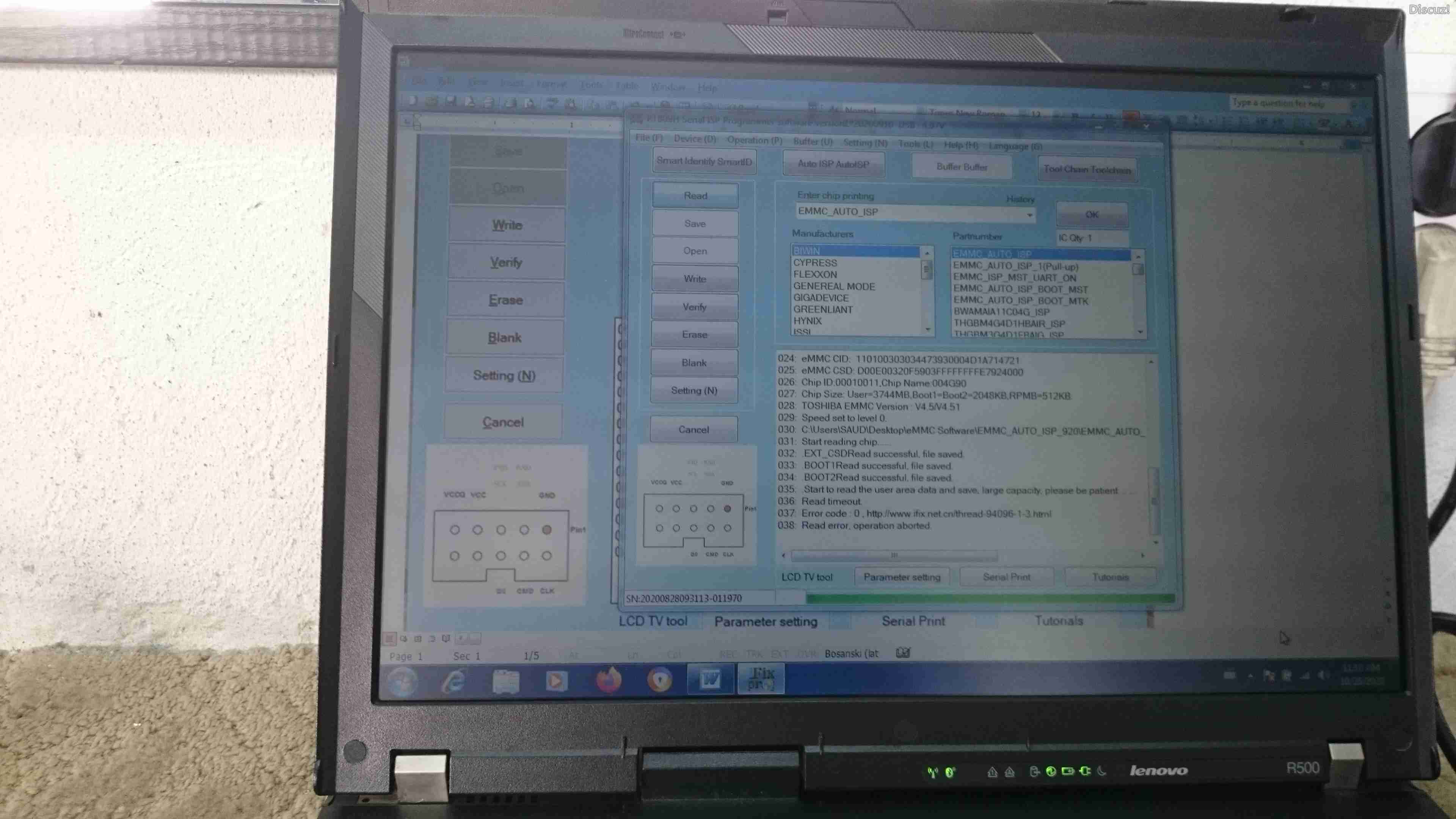

I tried with another Panasonic TNPH1077 1A mainboard. I managed to do a READ. The EMMC dump from that board is now stored on my computer. However, when I tried WRITE with the new eMMC dump for this mainboard, the operation started but stopped immediately? I received information that there was a CRC error  and that the write operation was aborted! Immediately after that the RT809H program was blocked and on the display of my computer I received a message that the program was blocked and that I was looking for a solution on the Internet or to terminate the RT809H program. To note, I restarted the program and tried WRITING again but I got the same! I think this RT809H programmer is usually bullshit and not good at all. I think his purchase is a waste of money and he can’t work as an external ISP programmer at all.
 楼主| 发表于: 2020-10-28 19:01:28
I don't think this programmer is able to write Panasonic mainboards.

Why don't you introspect on that?We've done the best we can for you, and we personally bought the board and tested it.You change a board can read normally, proving that the programmer has no problems.Now write read data to the original can not read the board error should consider the chip cause.For poor performance chips can be erased first and then slow down the test..Replace the EMMC chip test if possible.Based on my experience in repairing tens of thousands of TV mainboards, your level of shirking responsibility and swearing is a hundred times higher than the maintenance technology! 1111.png

Obviously the EMMC is bad. Does anyone know programmers better than you?
