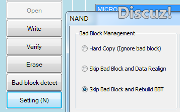

First of all, there is a common sense that any electronic engineer should know, that NAND Flash is allowed to have bad blocks, and that the physical bad blocks can't be fixed by any programmer, what the programmer can do is to skip the
physical bad blocks, and RT809H certainly has that capability.
Some programmers claim that fixing a bad block is actually erasing a bad block sign on a bad logical block, and RT809H does this automatically when it's erased or written .

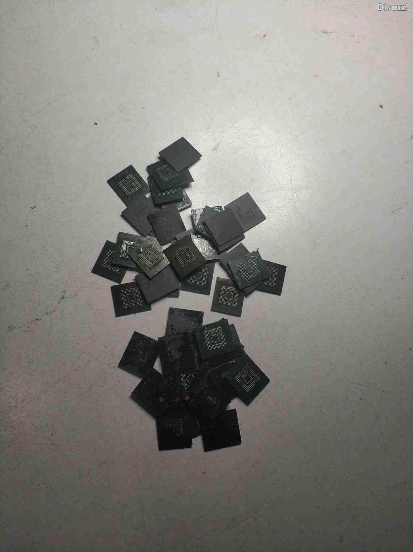

It is obvious that you have come to make trouble, and the bad performance of the chip professional instruments can not be detected.You first load the whole process of normal video uploaded to the network let us have a look.By the way, look at how many EMMC chips I've changed this month QQ图片.jpg

How did you detect the malfunction of these chips? Did RT809H reveal it to you or did you guess it by heart? A master without a reliable instrument is a quack!

The 5G5A does not support life display, although life does not measure chip performance, but can be referenced.5G5A began to be used in large quantities in 2013 and entered the maintenance period in 2015.I have encountered more detours than you, but I have accumulated a lot of experience.Besides, maintenance is not the production of chips, what you said is the chip manufacturers to consider, don't bother.Learn more maintenance knowledge to increase income is the absolute truth, my dear friends do you understand?
