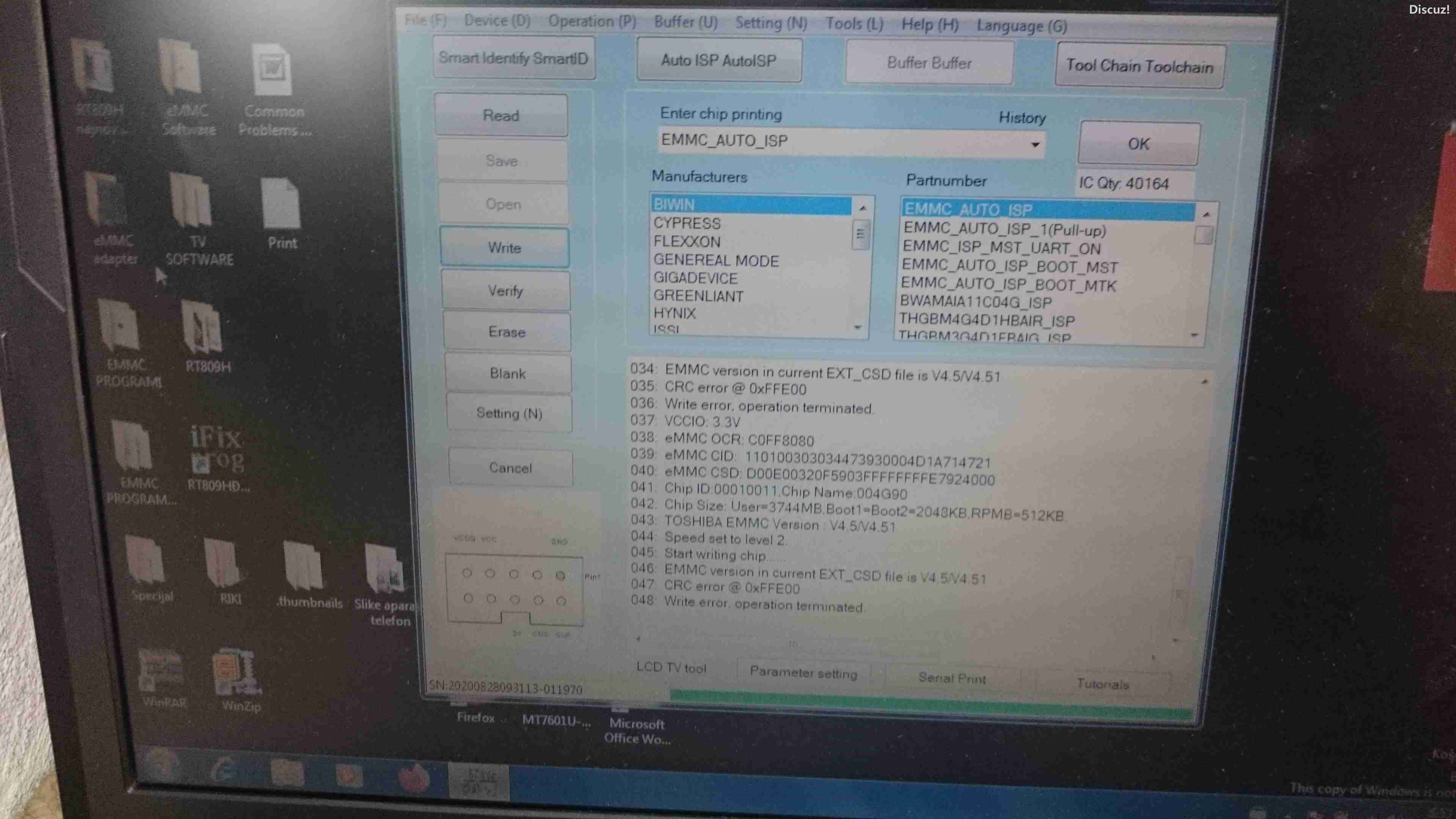

Hello  dear friends !
Nice to meet you.
I bought the RT809H and installed the software normally.
However, I can not to write a Toshiba chip THGBM5G5A1JBAIR with EMMC ISP.
Of course, neither reading nor writing is possible. MyRT809H programmer finds this chip in automatic as well as manual search. Andnothing more can! I tried with EMMC_AUTO_ISP and  with manual searh as THGBMBG5D1KBAIL_ISP, butin both cases I get the same writing problem . When writing, my programmer startswriting but it immediately stops with the message: "Write error, operationterminated". The program then blocks and whitens and I get a message tolook for a solution on the internet. After I click on it the programautomatically restarts and I have the same problem again, I can't write thischip!To note, I did everything correctly. I found and connected the points:CMD, CLK, D0 and GND. I did not extend the original ISP cable. I cut the CMD,CLK and D0 lines between the eMMC and the main processor. I briefly connectedthe quartz crystal of the main processor to ground. I gave the correct externalsupply voltage to the eMMC chip VCC / VCCQ = 3.3V. Despite all this, I have thesame problem. To note, with other eMMC chips as well as mainboards from anderesLCD TVs I don’t have this problems ! Here is information about the TV and themotherboard with which there is a problem: Panasonic LED TV modelTX-39ASW654  sch. LA51, mainboardTNPH1077 1A, eMMC IC 8903.

My RT809H programmer recognizes this chip on automatic search as well as on manual selection as THGBMBG5D1KBAIL_ISP . However, when I try to write, the device currently says to wait and as soon as the writing of the chip starts, I get a program blockade that says WRITE ERROR OPERATION TERMINATED. Then the program table turns white and blocks and I get a message on the display to look for a solution to the problem on the internet. After searching the Internet, the program shuts down and restarts. When I start writing again I get the same result! I use separate power supply 3.3V from my service device? With other eMMC integrated circuit that are on the mainboards produced by Samsung and LG I have no problems. Only Panasonic mainboards TNPH1077, TNPH1100 , TNPH1120 and TNPH1111  make this problem ! Whu? I have good and proven Panasonic software that I need to write. Maybe this RT809H programmer can't do this programming? I am very disappointed in the RT809H and I think it is not a good device for ISP programming at all, as it is written in Chinese commercials? I made the mistake of buying it at all and I will pass on my bad experience with this device to all my colleagues. If you have the Email address of the constructor of this shit, I would like to kontaktieren with this sir  and convey my negative experience. Maybe he can help me?

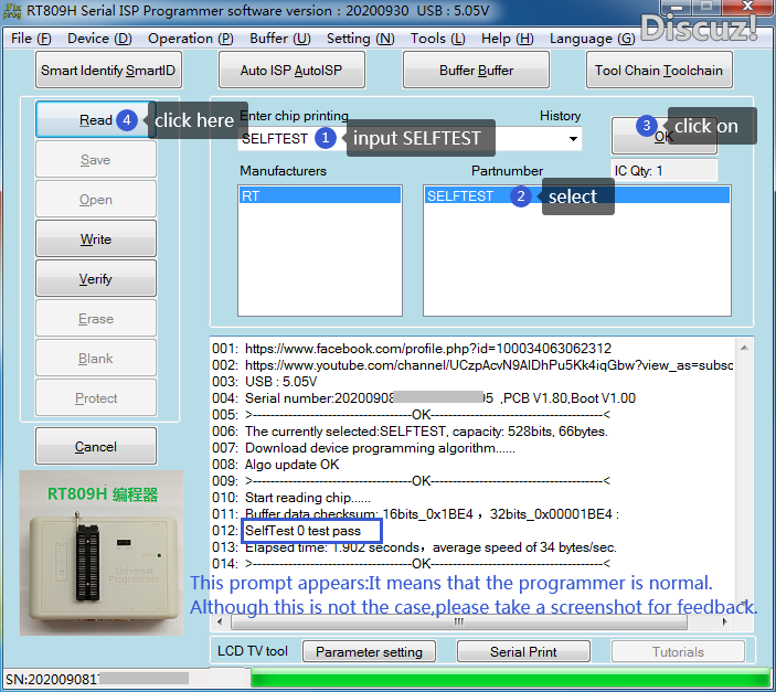

1.Only keep the USB data cable connected to the computer on the programmer for ‘SELFTEST’ of the programmer.
If there is a problem with the self-test, the MOS tube may be damaged due to the leakage of the soldering iron.
selftest
selftest

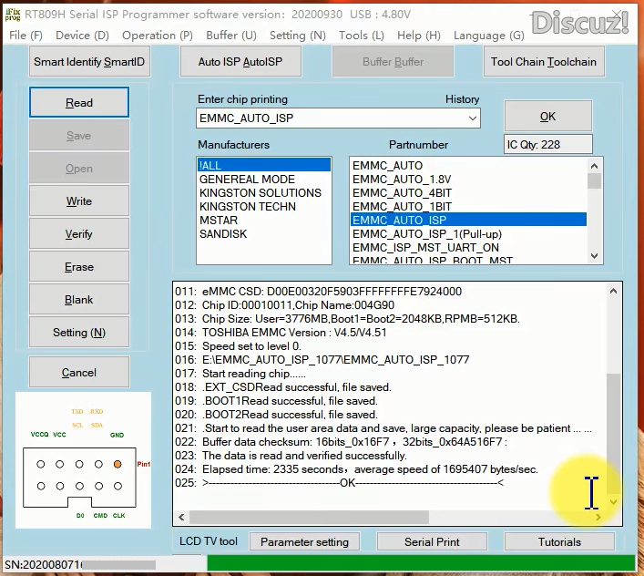

4.Reading completed
READ
READ

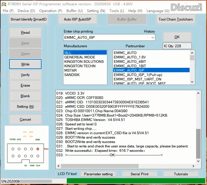

5.Write complete
WRITE
WRITE

We have bought and tested the board according to the model you provided. Reading and writing are completely normal. Have you tested it? I asked you how to operate it from the beginning. I have never seen you provide any operation process. At the beginning, I also emphasized the particularity of Panasonic machine.
