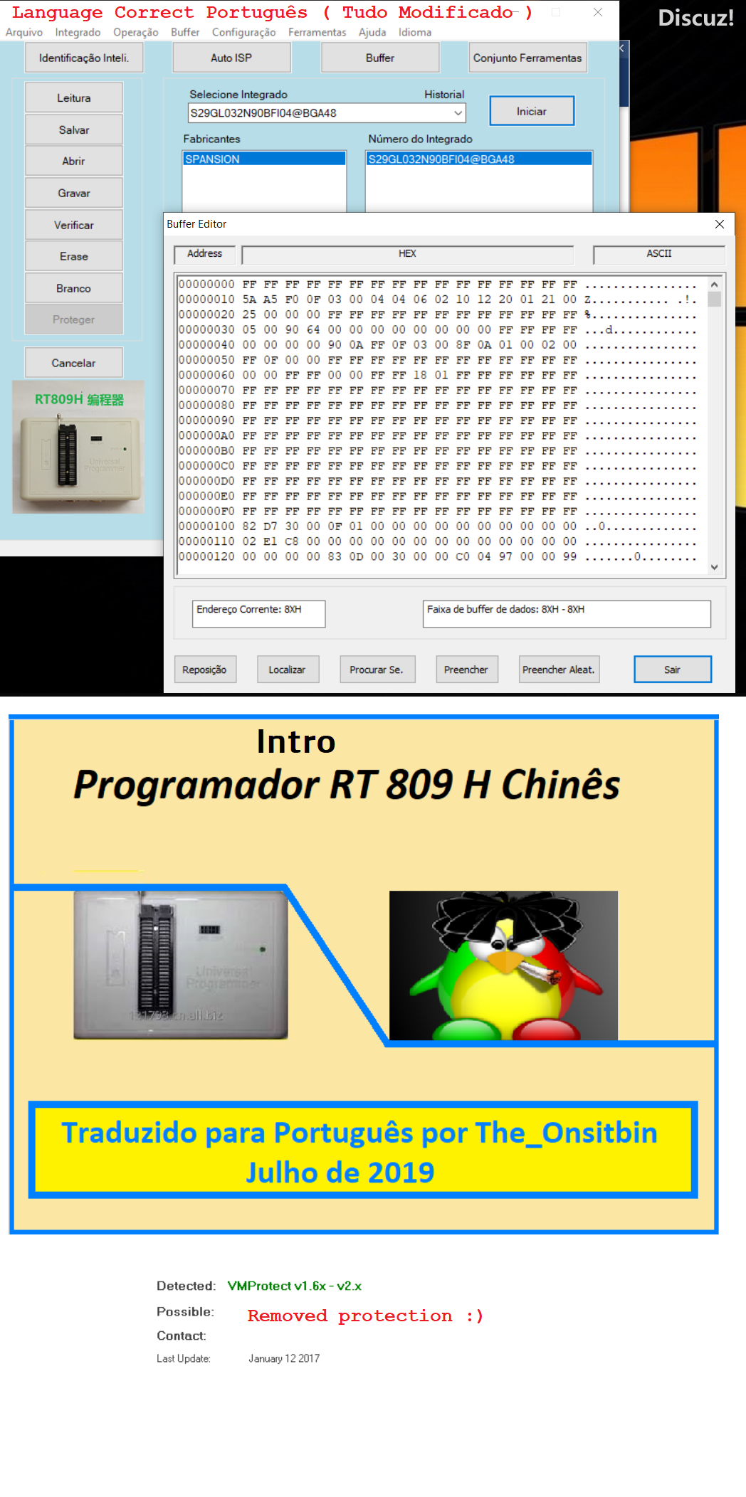

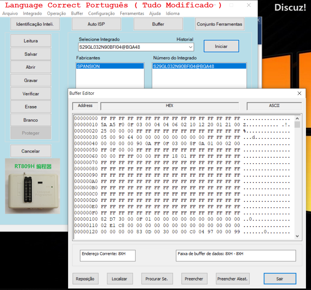

New Program.png Ligua Portugues de Portugal.png New Program.png Helo

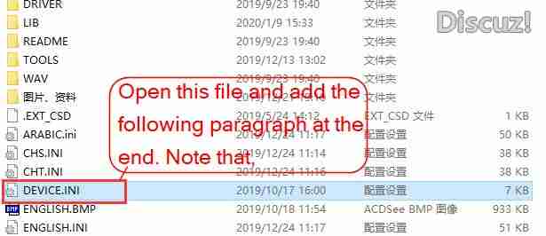

Try adding it yourself first,format:
[Chip40] #Note: do not duplicate the chip number with the previous one
ChipName=S29AL004D@TSOP48
ManuName=SPANSION
ChipID=0x000xxxx
x #Fill in the correct ID of the chip
ChipSize=524288
PinVal=0xFFFFFFFFFFFF
AlgoRef=S29AL008D@TSOP48
Note: do not write after "#"
