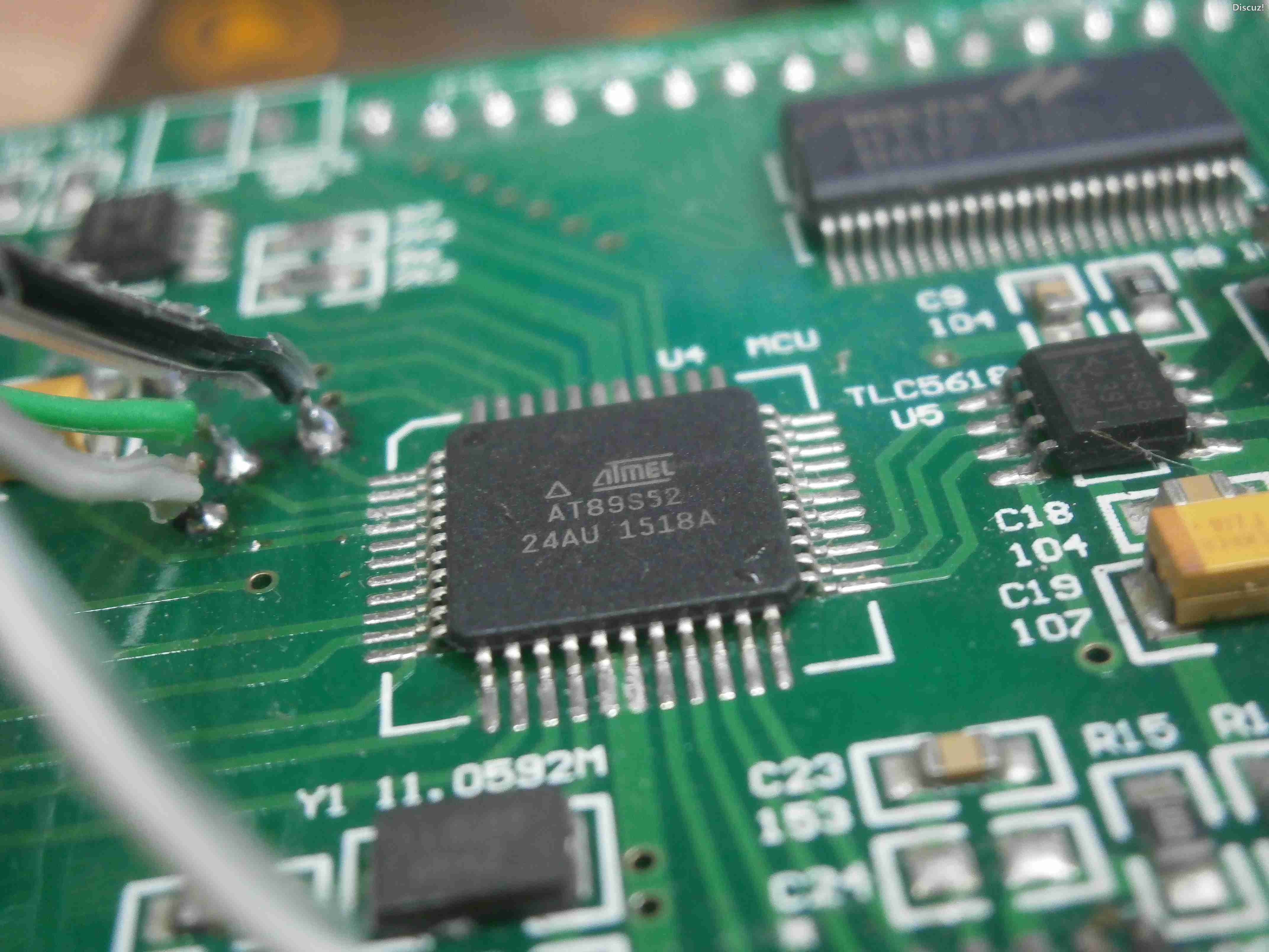

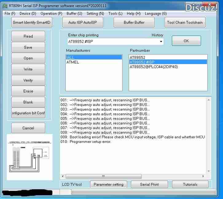

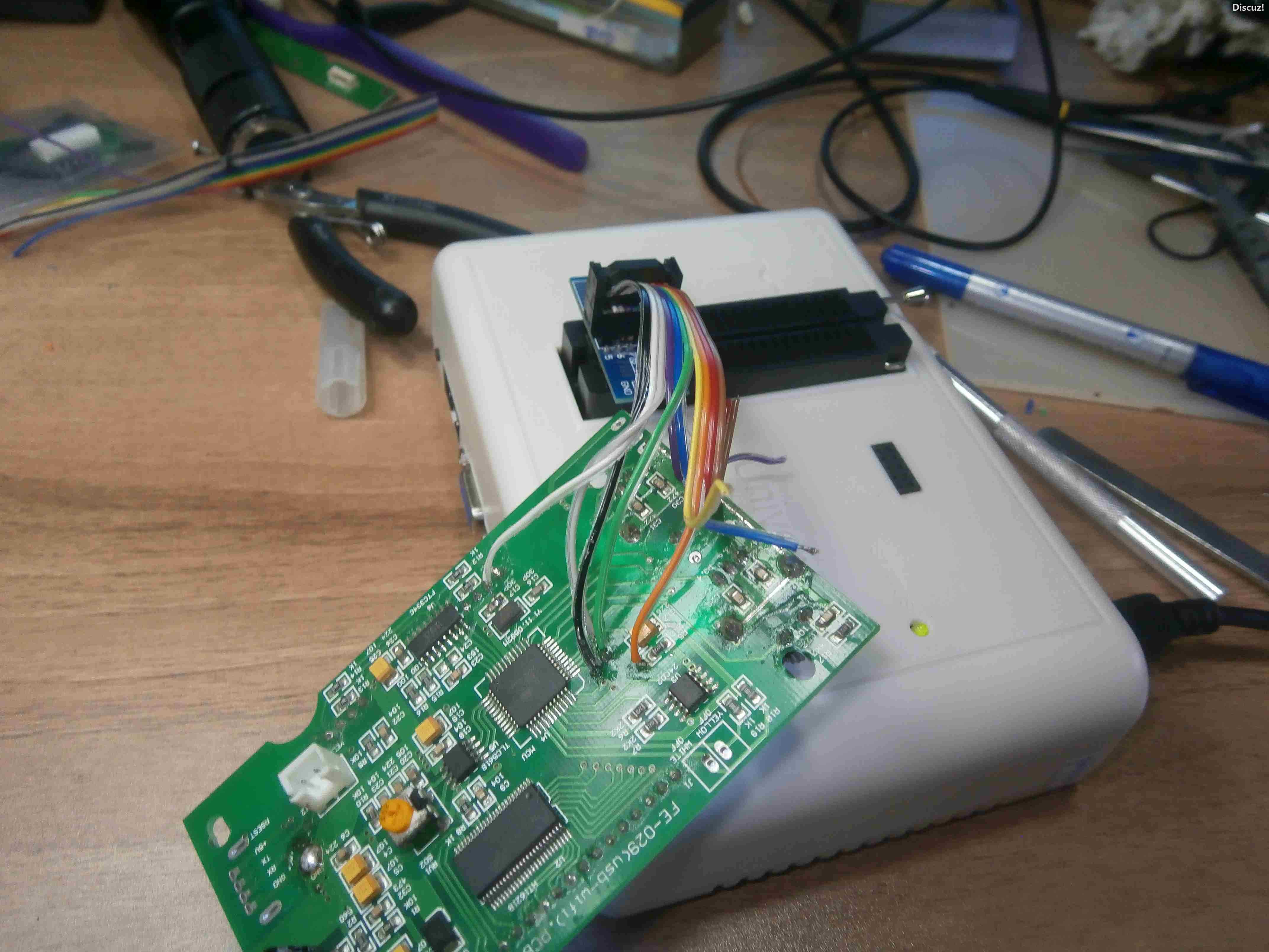

大家好,
阅读AT89S52时,我感到很失望。
它正在出错。
我使用了不到10厘米的电缆,但没有检测到IC。 和IC变坏。
请帮我 ....
001:  -->Frequency auto adjust, rescanning ISP BUS...
002:  -->Frequency auto adjust, rescanning ISP BUS...
003:  -->Frequency auto adjust, rescanning ISP BUS...
004:  -->Frequency auto adjust, rescanning ISP BUS...
005:  -->Frequency auto adjust, rescanning ISP BUS...
006:  -->Frequency auto adjust, rescanning ISP BUS...
007:  -->Frequency auto adjust, rescanning ISP BUS...
008:  -->Frequency auto adjust, rescanning ISP BUS...
009:  Boot loading error! Please check MCU input voltage, ISP cable and whether MCU pins connected. Make sure ISP cable length not exceeding 15 cm.
010:  Programmer setup error.
