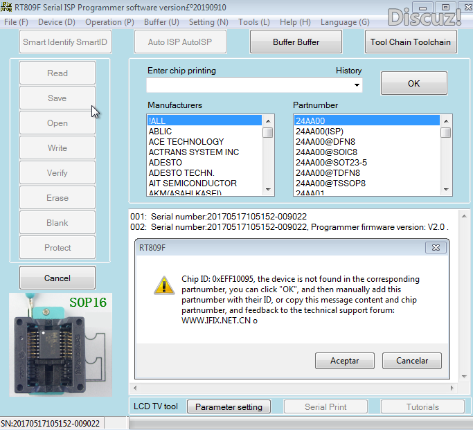

I need read a chip Winbond w29n01hvsina with my RT809F + PEB-1 and TSOP48 socket and I got the attached error.
How can I read it?
This flash is from a ONT router ZTE F670.
Thanks
Error
Error
发表于: 2019-12-28 09:14:43
Sorry, as so far, RT809F doesn't support this IC, but RT809H support, you can use RT809H to program.
