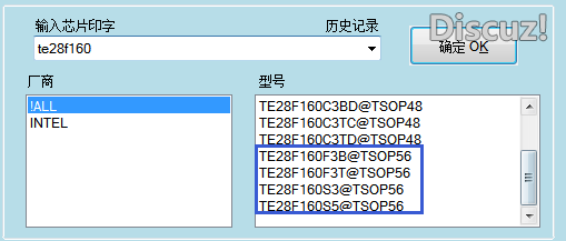

for INTEL TE28F160 - TSOP56, you can use the latest RT809H software to program, software download :http://www.ifix.net.cn/thread-94376-1-1.html
  And for Atmel ATmega88PA, RT809H also support, input atmega88 at the Chip printing box 微信图片_20190718093519.png

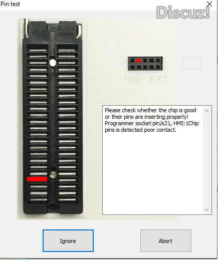

besides, when I try to read the TE28F160S5 I still have a message with a poor connection 2 pins, the problem is on 4 different chips, ignore it, the reading is done correctly, but the verification is always wrong, should it be so?
