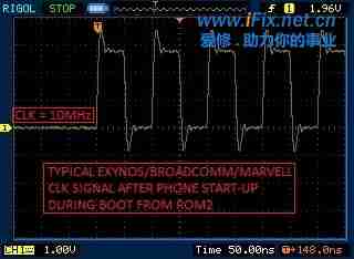

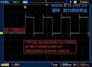

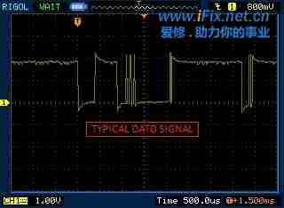

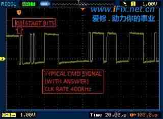

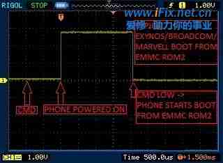

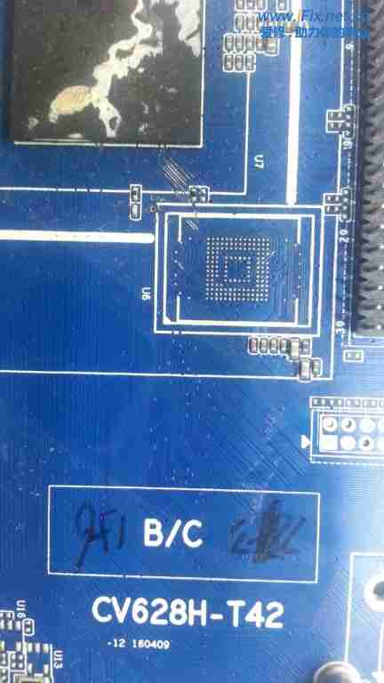

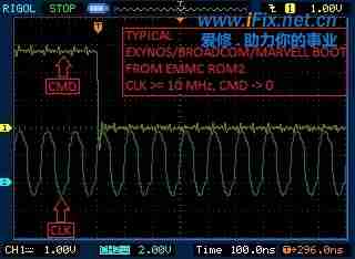

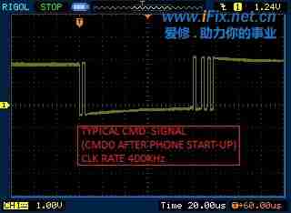

EMMC ISP TP DISCOVERY
发表于: 2018-7-2 23:04:06
