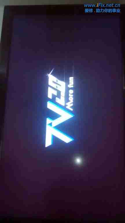

长虹LT46630FX LS30机芯 卡在开机画面上 打印信息如下
发表于: 2018-1-16 14:36:52
INNT
77
[3456789AB][3456789AB]
0077
BOOTR2AP
Hello JanusA0000000
==== Time 140107
USB_Init_ConfigureUSB port 0 enter power save done
USB port 1 enter power save done
USB_Init_Configure done...
Unknown flash type (0xC2, 0x20, 0x17) and use default flash type 0x0503
-------g_b6m10Installed ----0
--GetPanelStatusCheckInOut --1
--GetPanelStatusCheckLevel --1
--gPanelIdType=1
flashdb  Check Valid_NeedSave!!
s8SN0(8) s8SN1(7)
--g_u8CurrentPwmPeriodType=1
sar input test...
-CurrntPanelSel=28
----default color matrix-----
--HdcpLoading Ok--Id=909900
--CurrnetPwmSel=0
First GOP driver instance, flush GWIN HW
Mirror function (0)
ASSERT tv-apdvbappMApp_FileBrowser.c 660
ASSERT tv-apdvbappMApp_FileBrowser.c 639
VIDEOSCREEN_FULL
ccccMApp_Scaler_Setting_SetVDScale=0[GE] Wait Idle 0  10
[GE] Wait Idle 0  10
DSP code loaded successfully
INNT
77
0077
BOOTR2AP
Hello JanusA0000000
==== Time 140107
--gPanelIdType=1
s8SN0(8) s8SN1(7)
--Reset by Watchdog 2
sar input test...
-CurrntPanelSel=28
--CurrnetPwmSel=0
Mirror function (0)
VIDEOSCREEN_FULL

Bin用809f刷过还是一样。开机画面下,

开在开机logo应该是主程序问题,刷机
