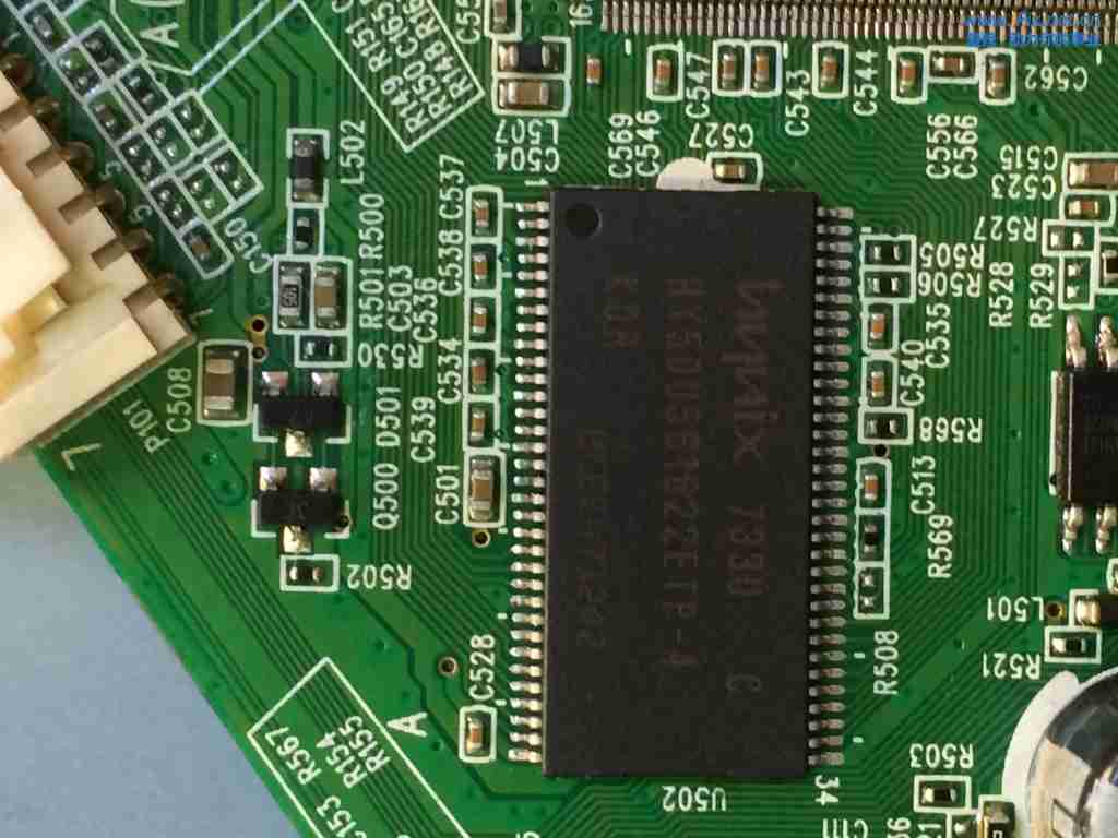

发个东芝32fl150c数据和完整打印信息
发表于: 2017-2-2 09:37:49
2017-2-2, 9:25:19
COM4, BaudRate:115200 bps, RXD: VGA->12,TXD: VGA->15, Printed by RT809F:
  SPI BOOT
Console Initial OK
Maria10: BD_MST004B_20AVS_10306
MIU: DDR_400Mhz_2x
BIST_0 PASS.
07 07
[ 05 06 07 08 10 11 ]
07 07
MIU Initial OK
Project id =1
Project id = 0
GEN_VER AFAA
GEN_FAC 81FBReload Period: 0 ms
s8SN0(71) s8SN1(72)
***stGenSetting.g_FactorySysSetting.u8PowerOnMode=2***
sar input test...
PJ_PanelID_HD******** 34
g_PNL_TypeSel is 34
panel is********* 34MDrv_PNL_Init u32PnlRiuBaseAddr = A0200000
MDrv_PNL_Init u32PMRiuBaseAddr = A0000000
[Louis.Yang]LED_RED_On[1]()
LoadHDCP_KEY
HDCP_DB_BANK 0x3A
GE_SetOnePixelMode
First GOP driver instance, flush GWIN HW
*******stUserData.TCL_PWMLOGO=1
[yangguozhi]stGenSetting.g_SysSetting.UsrLogo=0
[yangguozhi]u8IsAutoSleep_Skip_Logo=1
***EN_POWER_AC_BOOT ***
DSP code loaded successfully
devCOFDM_PassThroughI2C_WriteBytes Error--6
*****DESK******
ATVProInitialize
InputSourceType is 6
Set audio standard
>>>adjust volume>>>
>>>adjust volume>>>
easpect is 0lllllllkkkkkkkkkkkkk
[effect OPEN]:0
set CVBS mute4 2
CVBS Mute is 0[yangguozhi]AUTOMApp_ZUI_API_GetFocus[1]=65535

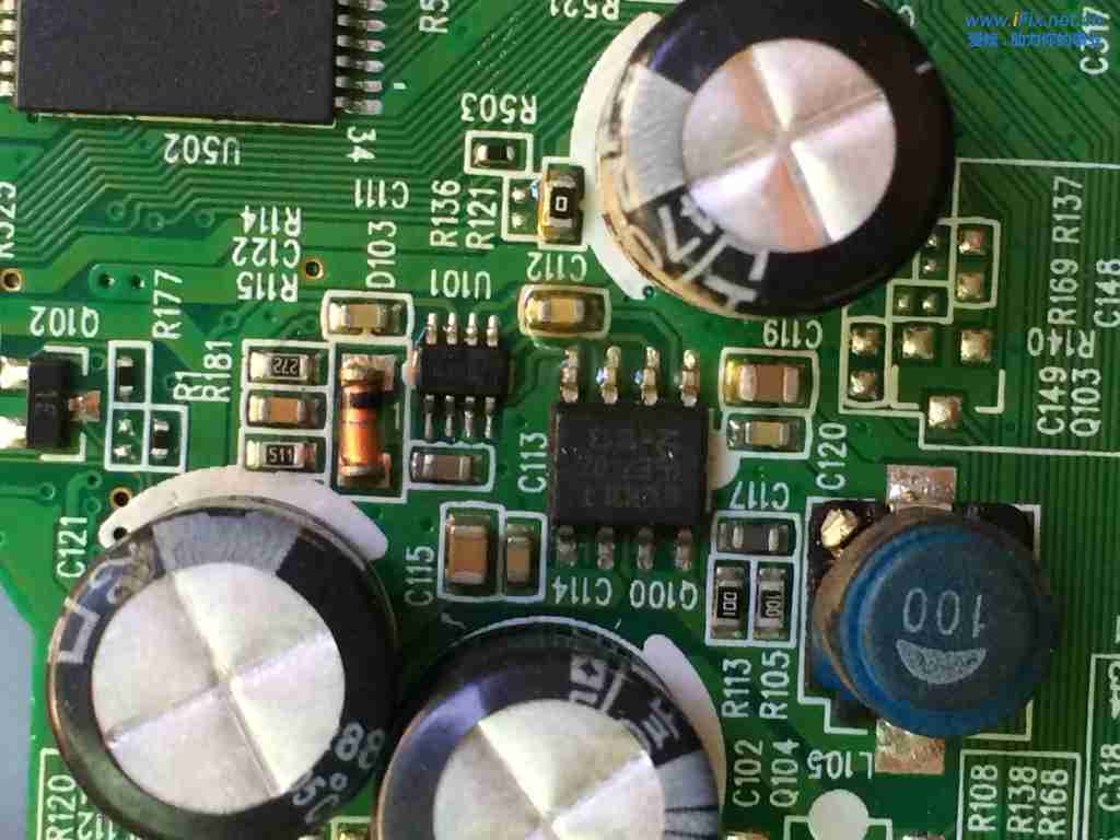

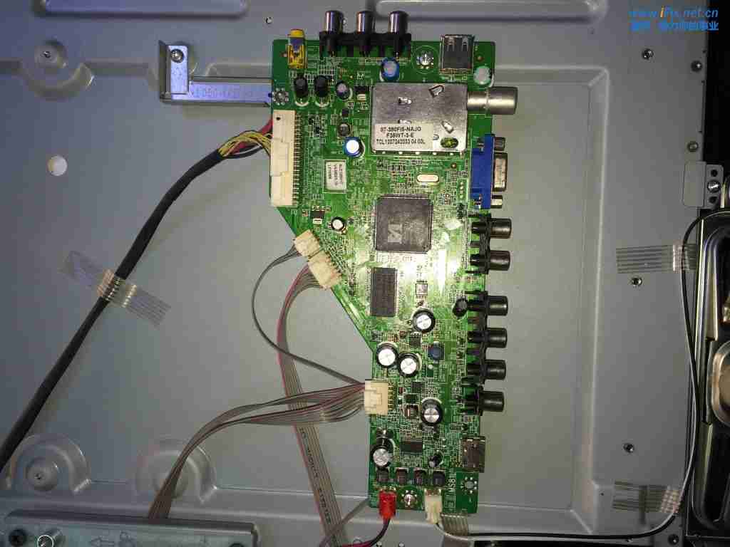

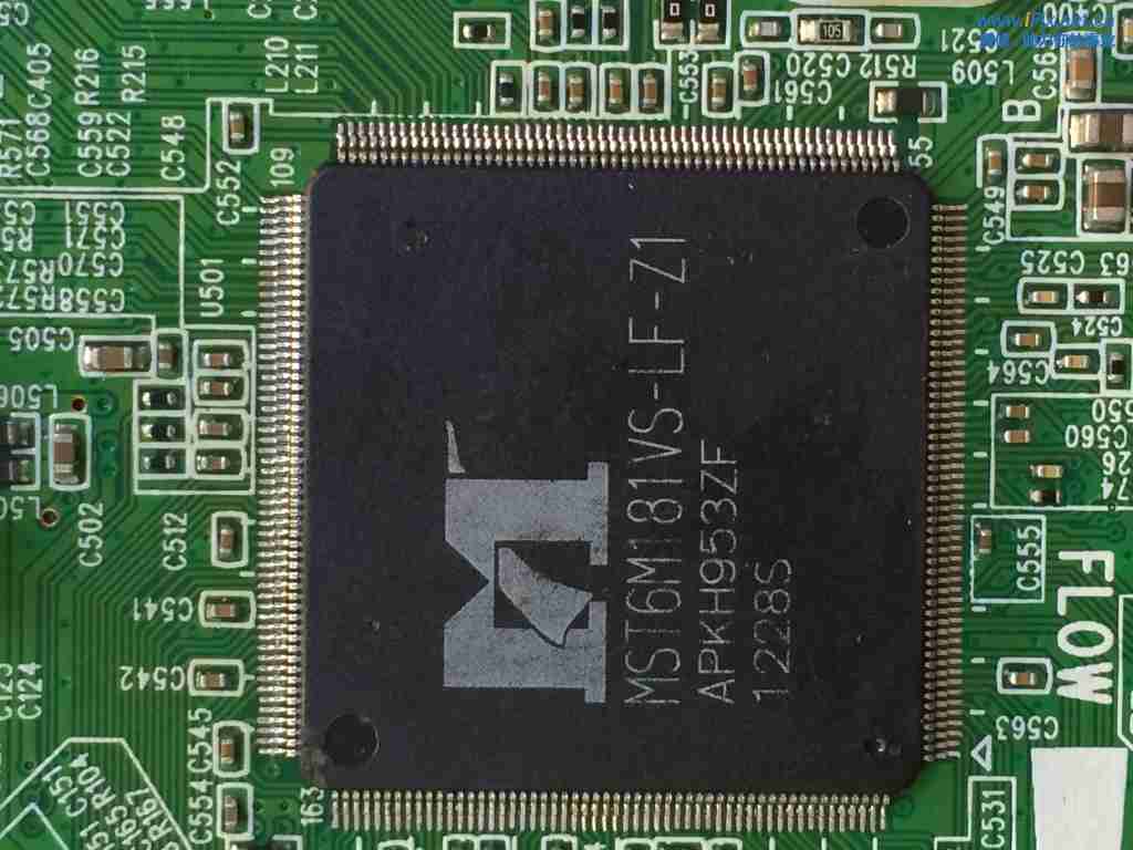

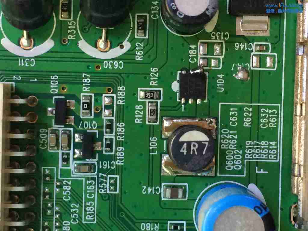

   昨天卡在LoadHDCP_KEY这边下不去,今天换6m181成功亮机。前后换了6脚1.2v芯片,ddr,q100,6m181。
