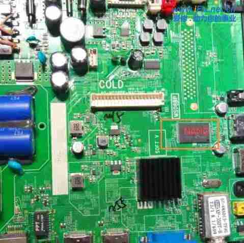

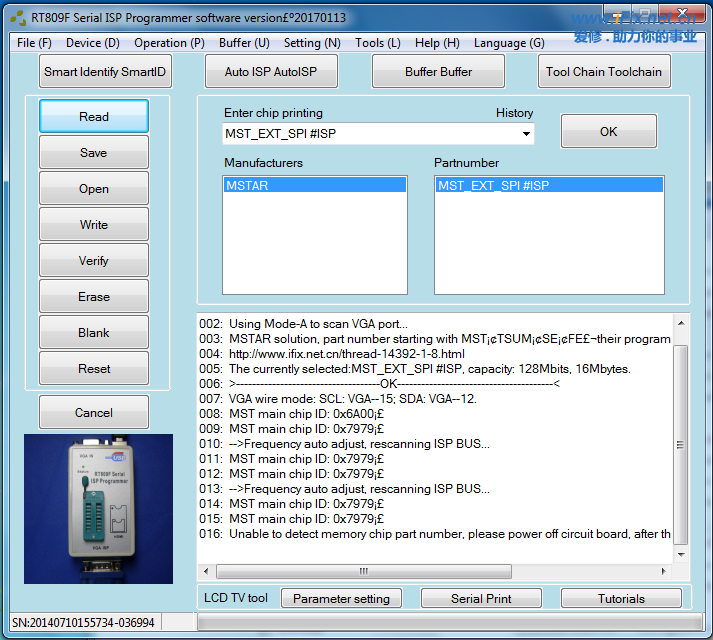

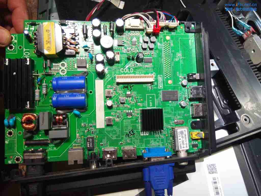

I am facing a problem while flashing software in TCL L40D2730A. When I try to write or Read using RT809F, It gives an error saying,  ''Unable to detect memory chip part number, please power off circuit board, after that power it on and operate again." Kindly help me to resolve this problem. Pictures and snapshots of Motherboard and RT809F Software are attached in the post below.

mother board 40-ms08bp-mac2hg

NAND chip network machine read is unrealistic, the machine has a problem, can write online guide, and then use U disk to upgrade system
 楼主| 发表于: 2017-1-22 12:35:31
upload picture brother
发表于: 2017-1-31 13:46:42
remove nand flash chip after conect PEB1 programer and 48pin adeptor after read writr this chip
thanks prakash  发表于 2017-2-1 10:25
发表于: 2017-3-11 11:12:46
sir now NAND flash without remove you program with rt809h
