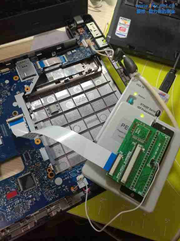

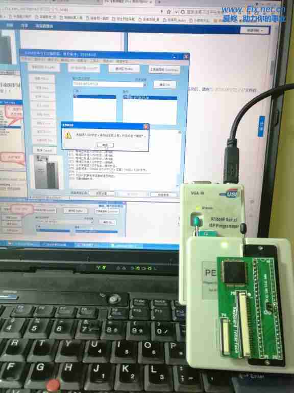

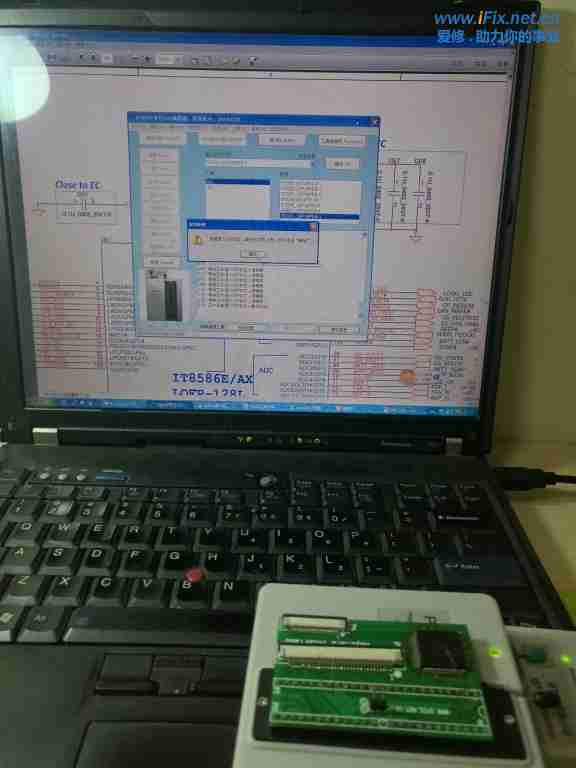

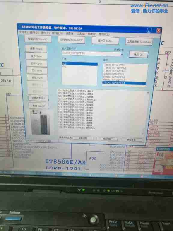

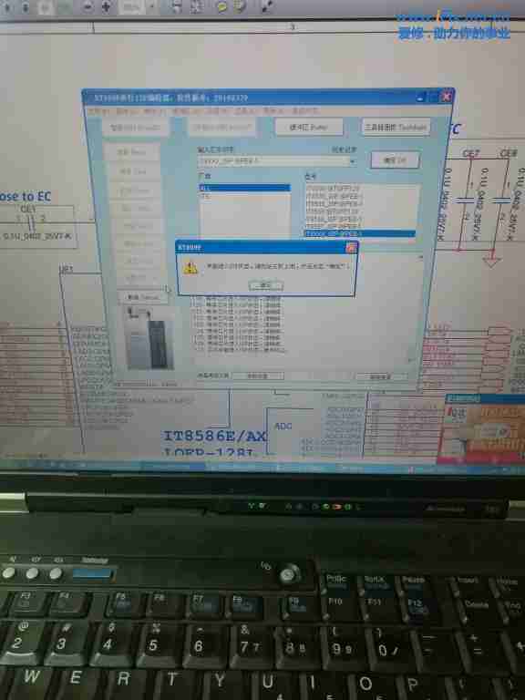

thinkpad E440 EC芯片为IT8586E,版本160810,总是提示未进入ISP状态, 离线和在线就失败,

the problem is that the IT8586E is not getting sufficient power from the USB. you have to  connect the 12V power supply to the programmer as well.
this is how I solved the problem to successfully read it online. I am using RT809H programmer.
