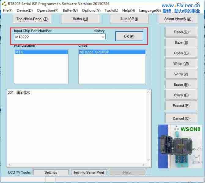

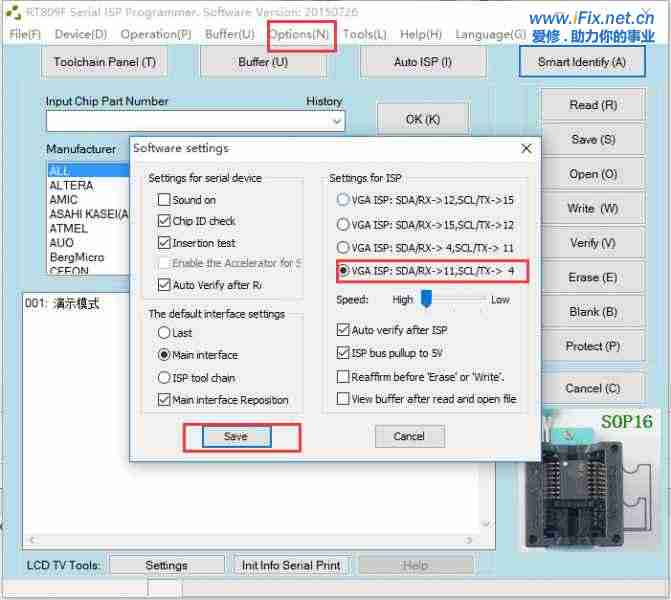

Use ISP VGA TV, encounter MTK series, please set the fixed line order, generally fourth, please do not point 01.jpg
Line sequence
In the "input chip printing" column, a direct input: MT8222, and OK

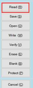

Then point
