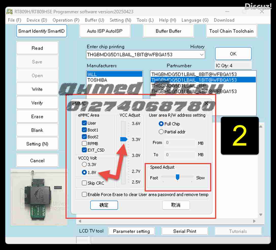

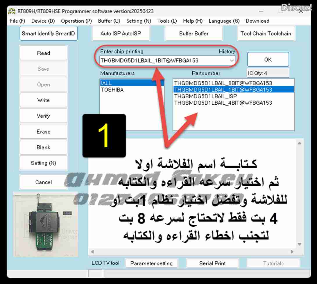

best sitting to read and write emmc with rt809h
thank you from egypt
VCC generally does not need to be adjusted, and VCCQ1.8V is suitable for most chips. If you make a mistake, the speed can be slowed down.  发表于 2026-7-6 10:57
