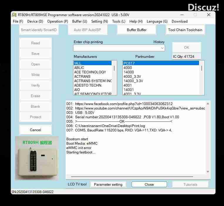

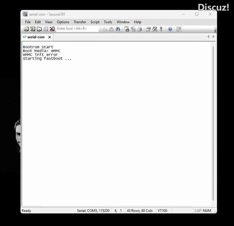

when i checked emmc after installing on mainboard and no indicator led
i got error
eMMC Init error starting fastboot
发表于: 2025-1-2 09:18:54
It is recommended to replace EMMC. The domestic software of this board is not compatible with foreign countries.
发表于: 2025-1-1 18:46:54
The printed information indicates that the EMMC initialization failed, usually due to EMMC and related circuit problems
 楼主| 发表于: 2025-1-1 19:10:06
技术支持008 2025-1-1 18:46
The printed information indicates that the EMMC initialization failed, usually due to EMMC and relat ...
Should I re-upload it and re-install it?
Do you have 8GB software for this tp.hv530.pc821 4k motherboard?
发表于: 2025-2-20 11:54:27
The moderator means that you need to check the test circuits related to EMMC connections. For example, issues such as a damaged EMMC chip, loose circuit connections, or short circuits may cause initialization failure. Based on the error messages you provided, it is more likely that the problem lies in the hardware.
