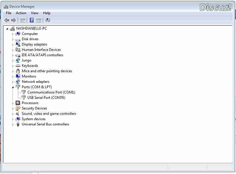

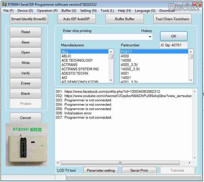

Can someone help me for this problem..
seems tobe the Programmer is detected buy the Computer.
software ar newly installed and driver..
antivirus is disabled..
but still "programmer is not connected"..
发表于: 2021-4-24 15:49:35
This is generally caused by the protection mechanism of the computer system, you can add 809H folder trust to try
