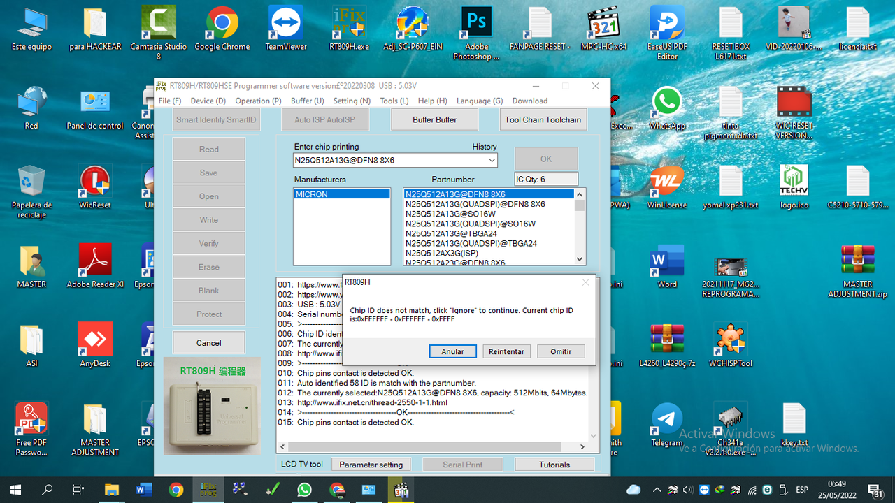

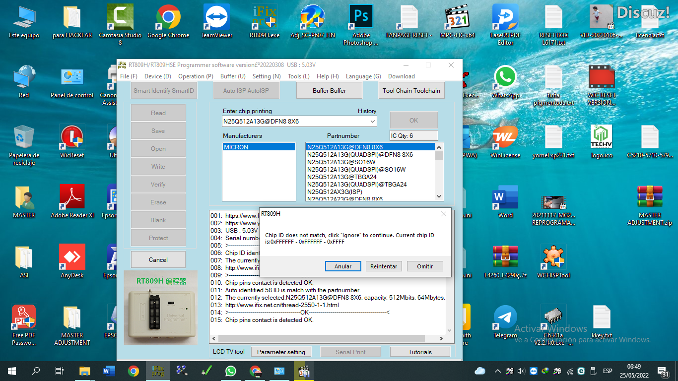

HELP WITH THIS ERROR???
CAN YOU ADD THE CODE OR WHAT IS THE PROBLEM

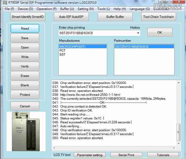

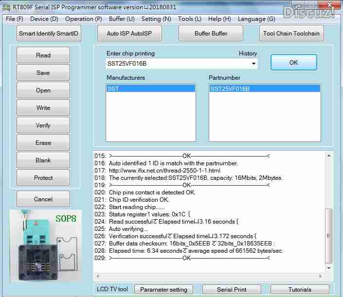

發現 RT809F VER 20220510 讀取SST 25VF016B 無法正常讀取必須更換為
Ver 20180831可正常讀寫
20220510
20220510
20180831
20180831
